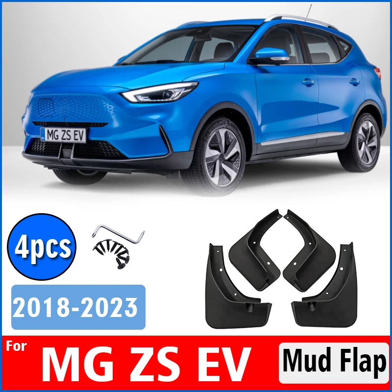

2022 After Market Mud Flaps ZSEV
These are a perfect fit for the MK2 Facelift MG ZS EV. I read on another thread that the MK1 dont fit at the back but the front do.
I ended up ordering the wrong set the first time so have learnt the hard way, but at least I didnt spend a fortune on them!
I remember seeing something similar to this on another thread but made this so others can tell the difference between the 2 models.
On the MK2 (Facelift) the read mudflaps have a longer section at the bottom before they start to curve, which is why the MK1 dont fit as its only a short straight secion at the bottom, the image shows it better than I can explain.

Fitted mine yesterday, I used the ones @farrells recommended from AliExpress, they fitted perfectly (y)
