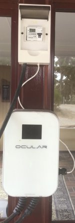

I am having similar problems. I have a MG EV ZS (2022 model, 44kWh). I am in Australia, and have very cheap electricity between midnight and 6am. I have set up a timer switch to act as the "on/off" switch on my "Ocular" charger. It had a SPST push button switch to turn it on or off, so I replaced that on/off switch with the attached programmable timer.
However, when I get up, sometimes the charger is showing a message "Waiting for car", and the car has only charger 9 or 15 kWh.
So I too am looking for a way to look at the "charge history" in the car, and look at why it disconnects.
I am planning to buy a OVMS Base Component, and hopefully will then be able to interogate (at least) the last charge.
Is this a sensible approach?
