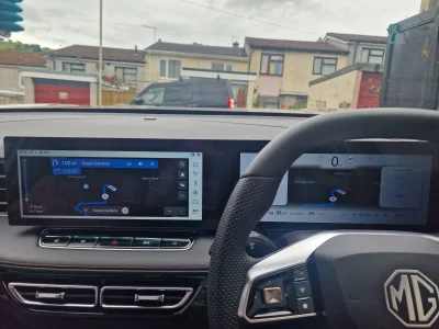

Hi.
I have noticed an issue and wondered if anyone has a similar issue.
The navigation screen only remains in the dark mode even if the screen setting is set to light/dark/Auto.
The screen is ok as it only affects the Navigation.
The issue is intermittent and only I can nearly all the time rectify it by scrolling through t the different screen settings as listed above.
This happened the other night when I also had the navigation on the drivers screen but you couldn’t see anything as it was totally blacked out.
Happened on the way home again today in full daylight.
Would like to know if others have had the same issue and if it was fixed etc
Thankyou
Lawrence

I took mine back to MG, who tried to correct this with a software update, but it was unsuccessful, so they contacted technical china who agreed for both screens to be replaced.
They have worked perfectly ever since.
Thankyou.
Could’ve ask did it only affect the navigation screen as the other screen options work ok switching between light and down with no problems.
It affected both screens I have attached a picture

Exactly same as mine, at the moment it’s behaving, I know if I take it to mg they are going to say couldn’t find a fault
For me every time it happened I took a picture some day time, some night time. I showed them all to the dealer so they took the car in. They left the car locked for a short time and when they started the car the error showed as you seen in my previous post.
