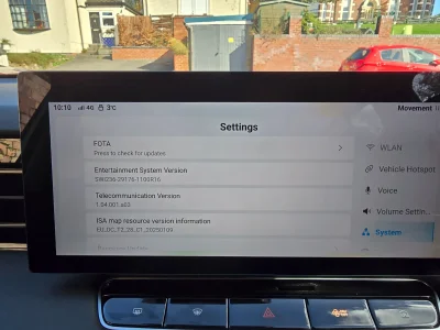

My new lease 75-reg PHEV Trophy arrived this week (Registered new years eve, delivered Friday but I'd asked them nicely to do all the updates before sending it, so it seems like they may have done?)
The newer SWI236-29176-1100R16 System version and 20250109 Maps.
(Hoping this is 1st September rather than 9th Jan!)

Picked up my 2026 Trophy PHEV on March 17th. Came with latest software version SWI236-29176-1100R16. Interestingly in the few short days I've had it, I've suffered none of the reported issues previously stated so perhaps this version is the sweet spot for this car.
