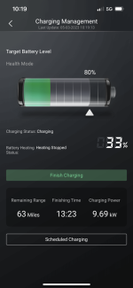

MG 5 FL has onboard 11kW (max I can pull from AC "charger"). When I am using a 22 kW charger I will get an average of about 9.7kW.
