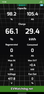

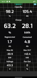

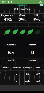

I am using the EV watchdog app at the moment and I like it a lot ? at first I thought some of the information may not be quite right like average MilesperkWh as it's more than the car shows but it does seem to work out correct at 6.4 mpkwh for the trip home from work this afternoon the car shows 4.5 mpkwh , i did 8.8 miles and used 1.3 kwh , the trip home is downhill and flat roads for about 80% of the journey , I like the instant and average mpkwh as it updates much quicker than the car and helps a lot with efficient driving and it's good to see how much kwh there is in the battery pack at any given percentage , fully charged mine was 41.6 kwh at 93% which is about right for what we know is the usable kwh for the car ???
