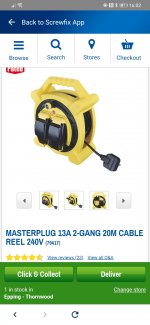

Is. I was thinking of getting something like this:
Would that be safe would it? I've always heard don't plug your car into an extension lead however if its got the right wattage, ampage etc i can't see why not? I'm no electrician.
As Adam says, it has to be fully unwound. Otherwise, it acts as an inductor, overheats and melts.
Not with this one but with a previous EV ......it needs to be:
1) Capable of a continuous 10A
2) Completely unwind it.
3) Ideally fitted with a thermal cutout
4) Make sure you plug into a good quality 13Amp socket and just as you would with plugging the Granny in, keep a check on the plug temperature and watch for signs of excessive heat.
5) Obviously kept dry
