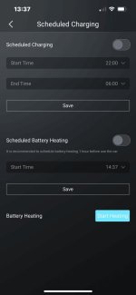

Now nobody wants to be Losing any beauty sleep myself included so in your ISMART App for the MG4 your correct you can’t set the amount of charge and then have it stop (we are talking MG4 SESR here before the owners of the LR and Trophy dive in) but Rolfe, in the app you can set a start and stop time see my pictures below which are from my wife’s MG4 SESR app on her Iphone.
So click on Charging Management and that will take you to the next page below
You will note here it says 80% just ignore that for the moment,
Click on Scheduled Charging that’s takes to the timer page next picture, and then in the top right Toggle Scheduled Charging which will go green then enter a start and end time and save it, don’t worry about the battery heating setting just ignore that, now back one page and you will see in my next picture the 80% has changed to 100% as you can’t control the percentage on the SESR so you need to Estimate the time needed to get where you want to be, and set the stop time which will stop the charge and jobs done (example on a granny charger around 2.4kws it would need around 5 hours for 10% to go in and 50-80% around 15 hours )so now you can continue with your beauty sleep.
Now when you plug in it will start the charger right away so set the starting time for around the same time as you plug in it will not control or delay the starting time as far as I know, but it will stop the charge and when it does the green light on the granny will be flashing as it is waiting for the car to charge again.
So below I have st an example for you to see once you have set the start and finish times
Once that’s done it will then ask for you password
So insert that and then you will get a little car doing a dance for a moment or two and then that will go of and the next screen will say success right at the bottom middle
So Rolfe if you do only want to charge to a set % this is how you can do it on the MG4 SESR hope this might help it may need a bit of practice and patience but it does work I have tried it on a 7kw but I will at some point but I bet it’s the same as the car is controlling the off time not the charging point.

Thank you very much for going to all that trouble. I understand now. That really is a very clever work-round.
Shouldn't be necessary, of course, but it most of the work-rounds we're dreaming up shouldn't be necessary, and at least we're beating the software into submission.

I was thinking, with the granny charger, start the charge and then see when the app thinks it's going to finish. I don't know whether one could then simply add a command to stop an hour earlier to that, or whether it would be necessary to stop it all completely then start again with the time limit set, but no doubt some experimentation would reveal the answer.
Hi Rolfe as S before once you plug in the charger. It will start to charge you divide for how long by setting the stop time in the app
Just one othe thing be sure to switch off the timer toggle in the app in my 5th picture down to cancel any timer settings. Other wise you may have an issue charging outside the set time so toggle on to use timing toggle off for everything else
