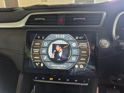

After spending about 12 months posting here on this site and any other forum I could find, I have given up and have now successfully setup a "Android 14 Smart system CarPlay Ai Box 4G 8-Core Wireless CarPlay Android Auto For YouTube TikTok Netflix Car Accessories" using AGAMA Launcher which allows me to run and app I want.
I love the car but it has been let down by people that don't know how it works.
