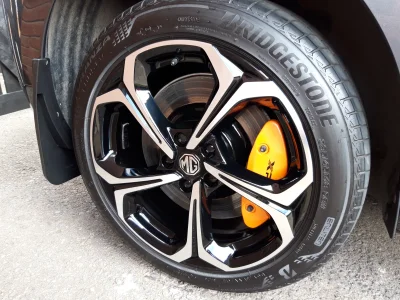

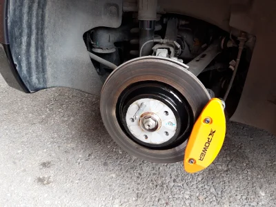

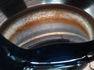

Hi @ssh, welcome to MGEVs, this is very common with all vehicle brakes, not just MG. This is what mine were like after just a year.
I painted mine black to match the wheel colour, and they look so much better for it.
Just be sure to use them a few times per trip, don't leave it all to the regen system and that should keep them clean.
