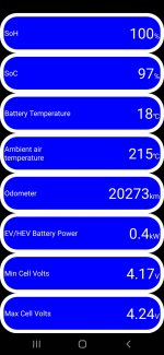

I just chrged the car and balanced the battery by restarting the charging when ik was already full and connected the ODB2 reader. Attached the results.
Some questions notes:
Unit one shows a battary voltage difference of 0,7 volts.. even though the SOH is 100%
Soc is at 97%
Last maintenance was in july this year.. is the BMS update for all country's?
Max voltage is at 4,23.

That looks like it was still balancing, not completed, as the EV power is displaying 0.4kW

No it was already finished. Thatvusage is duebto the fact that you have to turn on the car to get the SOH value. Without it being turned on the main relais disconnects the HV battery.

It's positive current (hopefully the sign is displayed correctly) which seems to mean discharging the battery. I would have used the convention that discharging the battery is negative current, but I don't get to decide things like that.

The balance process takes place automatically once the car is fully charged (on AC).
You DO NOT restart the charge process once it is fully charged to initiate the balance process.
The car will not initiate a balance process unless it is when it is plugged in the current state of charge is something like <95%.
When you take the readings, start the car without the brake pedal pressed, then the HV battery is not connected and ensures the car is under no load, then you get a good reading (battery power will not be 0.4kwh)
Your car is not well balanced if your min and max voltages are 0.07 different (4.17 - 4.24). When balanced it’s more like 0.02 difference.
