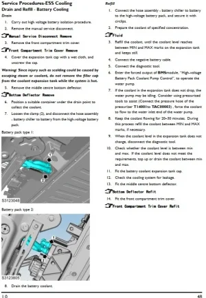

Hello, I have recently purchased a 100k car that's out of warranty, can the coolant change / flush be completed without a dealer computer,
The correct coolant is readily available. its bleeding the system that I would appreciate advice on please.
Looks like you need diagnostic access to run the coolant pump..

Can I just check that the diagnostic tool requirement would also apply to a ZS Gen2 in need of battery coolant change?
