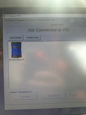

I’ve downloaded the VCI manager and am connected via USB to my laptop, but it doesn’t show as being online. I’ve tried a couple of different cables and reinstalled the software. Also applied the first hot fix from the Google drive, but the other two are blocked from opening. I wanted to test this worked before paying for the subscription, but do I need to have the subscription active for the VDI tool to connect? Thank you

Pretty sure mine popped up straight away. Do you get a light on the VNCI and the windows connection sound when you plug/unplug? Is there a driver install in the download folder?
I can see it in device manager, but under network adapters (rather than under USB devices). Couldn’t see a driver file in the Google drive but I’ve tried a few different ones from the net. Still no joy. Not really sure where to go next…
The adapter is ethernet over usb that's why it comes up in networking
Drivers are installed as part of the VDI manager
If you're using Vnci it's best to also install Vnci manager and check for updates
If Vnci is up to date and VDI manager still doesn't see it then it might be your firewall, to test it disconnect from the internet (turn off WiFi / unplug ethernet cable), disable firewall, check if it connects, if it does then you need to add software exception (allow app in Windows firewall) try again with firewall back on, if it works then reconnect internet
Firewall is your network security so disconnecting from the internet is for safety purposes, if you wish you can do the previous checks still connected to the internet
If you are still having issues then it might be worth having a read the the thread linked in the first post, others have had issues and rectified it, unfortunately I can't remember which pages and there's now 40 something pages

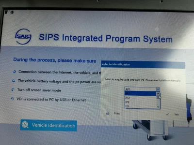

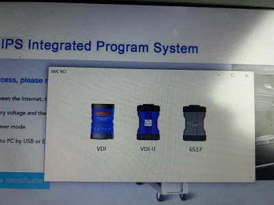

Thanks all for your help with this. I’ve made some progress today, although not entirely sure how! I’ve managed to get the VDI to connect, and am logged into SIPS, however it won’t identify the vehicle. It gives me these options, but I’m not sure which options to choose. I’ve manually entered the VIN which gives me some data, but won’t then let me update anything.

I've had that come up a couple of times and it worked selecting VDI and VDI2, not tried the 3rd option
Never manually entered vin, always auto found and then checked all the modules

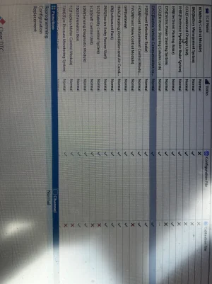

Thanks @haloweenhamster for all your help. I managed to get the ECC updated this morning. I’d bent one of the pins on the VDI device, once straightened it connected and recognised the car properly. Planning to test it tomorrow. One final question… is it worth updating any of the other modules while I still have a valid subscription.

The CCU update is also useful in my experience as I've noticed better reliability when starting a charging session on other chargers.
