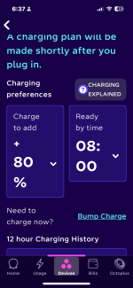

I was wondering if this common to all MG4 models, or just my trophy.

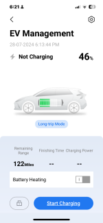

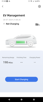

When I select “battery health mode “ in my vehicle, it always charges to 100%
And the option no longer seems available under EV management in the app anymore?
I also select 80% in the Octopus energy app and that also get ignored.
Im sure this hasn’t always been the case.
This is confusing as 80% is the recommended value to use on a day to day basis, and only 100% occasionally.

The consensus of what I have read so far is likely that the 51kW NZ/Au version doesn’t possess health mode even if it’s on the app and screen. Which is somewhat confusing as ours has stopped granny charging at low 80’s for no apparent reason a couple of times.
It will stop granny charging if the supply isn’t sufficient to run the battery heater and the battery is cold, or the battery is overheated and needs the battery cooling running. Normally experienced in winter at SOC above 95 when below 0C outside.
