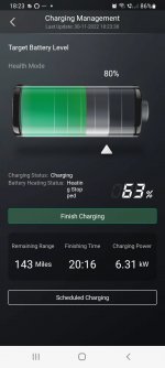

Battery Preheat.
Select "Charging Management" from the main menu
Select "Scheduled Charging" from the bottom of the screen
Select "Start Heating" from Battery Heating at the bottom of the screen
Once it is active, the "Start Heating" button changes to "Stop Heating" and you will get a message saying "Command Executed Successfully"
If you aren't seeing the Battery Heating option I suspect you will be on an old version of the app, so need to go to "My Profile" on the main menu and select "About" and then "Update"
