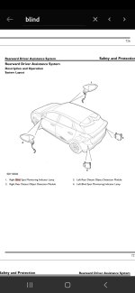

My blind spot detection system has recently stopped working on my nearside mirror. Offside still works. The orange light no longer comes on when a vehicle is in blind spot. Can't see any more threads on this system. I believe they may only be a Trophy feature.
Anyone else had issues with this? It was one if the most useful MG Pilot features that I liked.
I take it the sensor for this is in the mirror itself. Hopefully just a failed bulb/led. I'll live with it until first service in 3 months.
Check the camera lens under the mirror cap, it might be this that does the sensing and could be dirty. Just a thought.
I believe it uses the ultrasonic sensors in the rear bumper so if your parking sensors are working properly, it's probably a fault with the LED in the mirror. Don't know if this would be replaceable or if a whole new mirror would be required.
In that case you can test if it's the radar or the mirror by parking on street and slightly opening the corresponding door (carefully obviously). As traffic passes it will give an audible warning if the radar is working.
Sensor appears to be mounted behind rear bumper as per mg4mc and is not obvious from outside. Check image I found in service repair manual. I removed the small cover for emergency fuel flap release and could just see corner if what appears to be the sensor unit. Looks like to access it the wheel arch cover would have to be removed. Car is clean and washed regularly so nothing obscured by dirt. One for the dealer in March at service.
