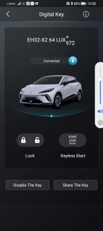

This is what I get. Unlocks shows as connected. Press start stop button and shows no key. Brake pedal depressed nothing. Disabled the digital key and started again still the same.

It connects to the Bluetooth fine and the command to unlock the car works, it just will not start.
The obvious stuff has be covered many times, the issue is with the digital key not being properly recognised by the car. It is not something we or the dealers can fix, it is a cloud server to car problem initialising the key.
Disabling the digital key turns the function off so it won't start with it disabled.
