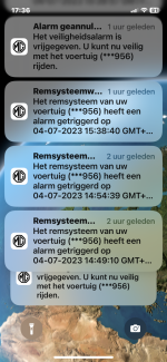

hello today this afternoon I had brakes light coming on red color and yellow triangle tried to reset the car several times with no succes . I have put the car to the dealer they gone read out the software , and hopefully they gone solved the problem. I also check the brake oil level and it was ok . get also text error message from the car too.

That's "brake system malfunction" in English, could be an auto-hold fault or something more serious. If auto-hold might be sticking brakes due to lack of lubricant/usage.
It looks a lot like the ubiquitous auto-hold fault, which simply goes away on its own.
