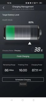

Are you Mk1 or Mk2? If I am interpreting correctly you are saying your Mk2 charges at 50kw on 150kw chargers? If so I think you have an issue somewhere worth speaking to dealer about, you should do a lot better than that.
