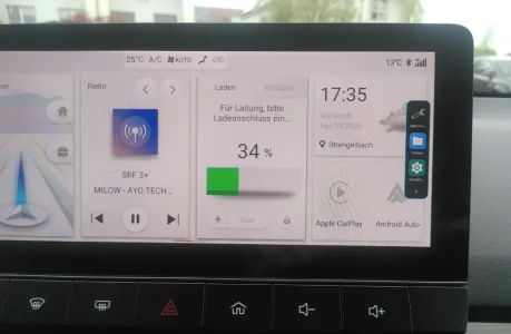

I think I I have came across this somewhere a while back and just want to verify if that is actually true? My 09/2023 Lux on R67 does not save it - how about the newer models like 2024/25?

In summer I am going to update the car myself (just waiting for better weather as I don't have a garage). But I know someone who's car is almost completely updated and he doesn't have that feature.
Recent software does save the setting of the OPD option, but the car will always disable it if snow mode is selected.
This becomes an issue if you set one of the shortcut keys to allow you to select your driving mode. As you cycle through the driving modes, you will end up selecting snow mode, at which point OPD is turned off until you enable it again in the menu.
The problem is that OPD is a single ON/OFF option, rather than being an independent option for each drive mode.
