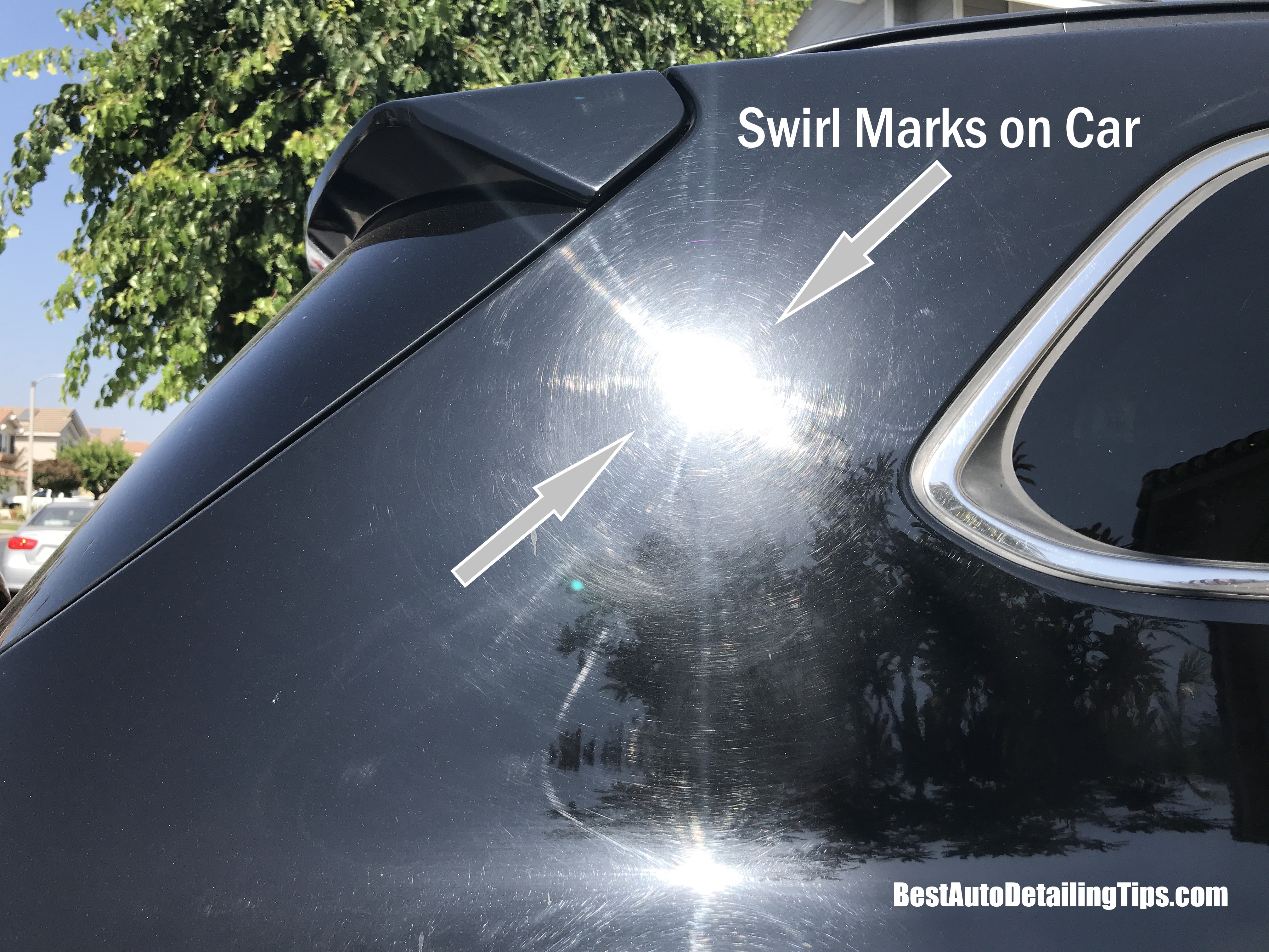

Doesn’t have to be special lighting my current car when I park it in the garage it’s just a strip light in there and you should see the swirls on that on the bonnet. This was like that from brand new and was supposed to have the Gardex protection on it before I even drove it home from the dealership. I didn’t see it like that until I put it in the garage. I suppose a lot could be down to the preparation of the car before they applied it but I will never know.
The dealer will just wash the car & put the Gardex on top of what ever mess is left, there will be no proper machine buffing or clay bar prep.
A good read explaining why a lot of brand new cars have swirl marks and or holograms

Any one had their MG4 Ceramic Coated rather than the Dealer protection package. Been watching some on YouTube and they show you the state of some brand new ones before and the paint work are full of swirls beforehand.
I did my own weekend before last. My first ever ceramic coating though I have been an OCD detailer for many years. Really pleased with the results and its not difficult but you do need to have 2 days set aside (and an understanding wife/partner!). I used Shelby Ceramic Coating and I'm really pleased with the results. Good preparation of paintwork is key.

Ceramic coating is just one of those things that many people won't care one bit if its there but then others will notice the difference. You certainly don't need to be in a studio to be able to tell. Once the sun starts to come out you can start to see which cars are properly protected and not covered in swirl city.
