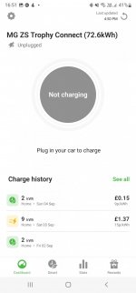

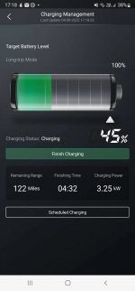

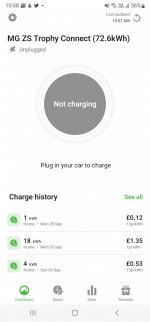

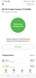

Clearly it's not working as intended. You asked for ~ 32kWh - how much did you get? I'd guess around 15kWh, about 20%. If so it sounds like your "smart" charge point is restricting the charge, possibly by advertising too low a maximum rate from the Protocol Controller.

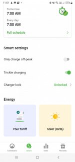

Is there a maximum charge option within the settings that would allow you to set it to just charge as fast as possible and see what rate you get then?
Can you also post up a screenshot of your settings - is it set for cheapest charge or least CO2?
Also, is there not a 3 year onsite warranty on your installation? Can you get the installer back?

No the only power option is to allow trickle charge - something which was relevant to the Gen 1 ZS unsure if that's the case with the facelift?
