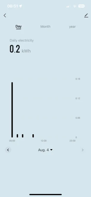

I have a 2020 ZS Ev and a Rolex QUBEV smart charger. My Octopus electricity tariff has a cheap rate between 12:30-7:30. Manual charging is enabled, eco charging (for solar) enabled s as well as scheduled charging.
I have performed several scheduled charges without and problem. The latest such charge was 3 nights ago Suddenly last night it started, charged .17 kWh then paused. I have restarted it several times. I’ve tried turning off eco: same problem. Also turned off scheduled. Now it always goes to waiting then straight to pause. Once or twice it seems to have added 0.01 kWh.

Thanks for replying. I wasn’t either. I did, however, go down the next morning and a) unlocked the car; b) removed and replaced the charger cables at both ends. Then it charged. c) Partially charged it (80%) then set it to charge on the schedule. All worked fine.
I suppose it’s possible that the plugs weren’t seated properly. Odd, though, I’d have expected a more certain connection at both ends.
