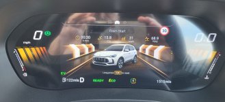

I noticed from your pics that you run in Eco regen 1 whereas I use Normal 2. I really need to read the manual to understand when to use each.
After 2000 miles I've achieved 46 mpg which is the same as I achieved overall in my previous MG ZS petrol.
