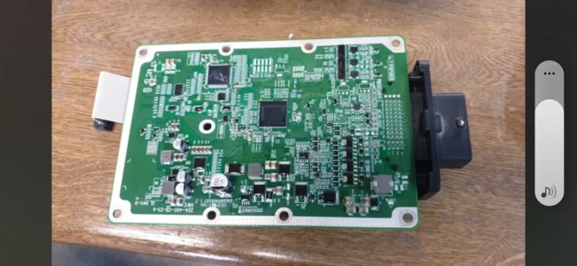

Yes true as you said but last night found a video of a guy which will be making an open board , in my case we are going to change just this board as he is calling it the logic board and hoping that changing that would fix my problem
Videos I see on YouTube they often swap out the modules / circuit board so the components think they are the original component. See this done for drive motors, inverters, headlights etc
This is what you have to do to code modules to a Honda, not sure if MG would be the same
