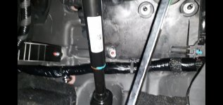

The job is done.
It isn't one continuous area and my sizes are approximate.
There are several areas above, to the left and right where there is bare metal or gaps.
They are located more by touch than by sight.
I ended up cutting a number of 30 cm squares which I rolled/folded and stuffed into the various gaps, making sure not to obstruct anything.
Also a 10 cm square and a 10 by 25 cm strip which I secured with double sided tape above and to the left of the steering column.
Hopefully I will feel a difference later. I may need to look at the passenger side as well.

You don't need a lot probably a 60cm square piece is plenty, just look under the steering wheel as the photos above show and fill the bare metal parts with this, it makes such a difference
