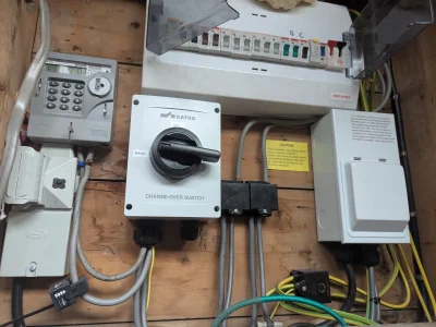

I've connected my V2L (MG4) to my home via a change over switch. However connecting to the house trips the MG supply. Even when everything in the house is turned off. Some have mentioned earthing may be an issue but that's over my head.

So if you turn off your consumer unit (fusebox big switch), operate your changeover switch and connect your MG it still trips? If so you have a wiring problem with your changeover switch.
If it doesn't trip in the above, switch on the fusebox if it then trips, you have a load that is too high for the MG, probably things on standby when theyre first powered take a bit of a surge. Switch off all of the MCB's (circuit breakers, reset the MG supply and switch the circuit breakers on one by one until the MG supply trips you will then know which circuit causes the overload. Turnoff all appliances at the socket of unplug, restore MG supply and continue until all MSB's are back on. Switch on the appliances one by one until it trips again and bingo, you've found the culprit.
Thanks for your easy to understand reply. I also tried connecting my mg supply after the change over switch. As soon as I pull down the big red master on the consumer unit it trips the car. Even with all other RCD s off. It does not like being connected to the house.
There's definitely an issue between your incoming supply / changeover switch and the MG. All relatively simple and it may well be to do with the earthing arrangements. Do you know if the changeover switch isolates the earth continuity from the grid supply and what sort of earthing arrangement is used on your grid supply?
Hmmm. I feel we are going round in circles here. I agree with everything @johnb80 has said above... BUT, I already asked you the questions about earthing in my replies to you on the other thread where you asked the same questions last month 🤷‍♀️

With all due respect, please get a sparky in to sort your issue out. There is no point asking questions on one thread of a forum, getting some answers, and then asking the same questions on another thread with the cop-out...

Yes earthing is over my head....the house has a earth rod and the change over switch has an earth. I asked the spark who fitted the change over switch and EV charger. But it's not his area I don't think why my EV drops out when connected to consumer board. I was hoping for an easy solution. Don't mean to upset anyone. Not sure who I could ask professionally to fix this. I don't think most electricians have experience with v2l to home issues. Appreciate advice given.
Hopefully this helps 🙏

The v2l cable would be wired into change over switch. It's not in currently as I had to revert to extension lead. It enters bottom right. Switch handle obscures CAR label. No MCBs trip on consumer unit. Box on bottom right is RCD for Zappi charger.
