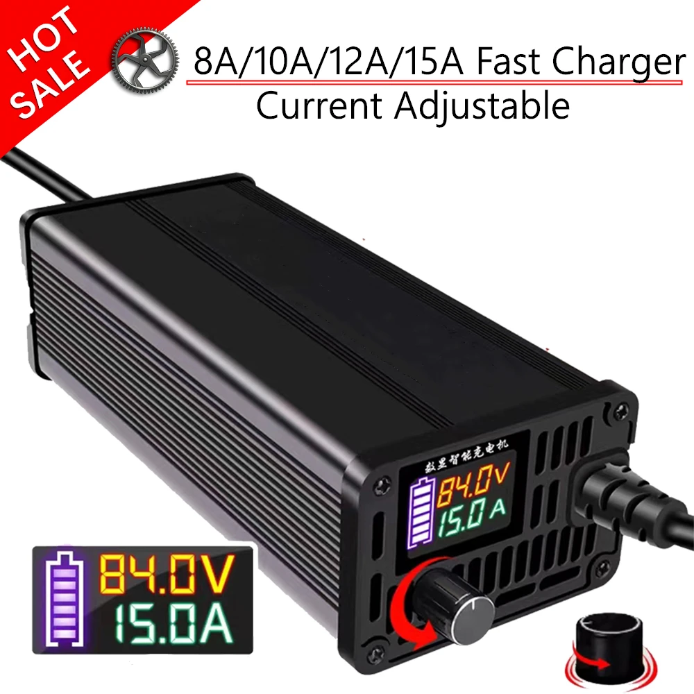

I connected to my DIY battery directly onto the DC wires (big black and big red) that go from the inverter to the battery. At this point the 48v DC is being fed into the inverter via the BMS (Battery Management System all batteries have). It's very easy to do and you could just purchase an extra battery cable if it's a commercial battery you have or even plug in directly to the battery where a second or third battery would connect (I tried this approach on my Growatt commercial battery). All that is needed is to connect to the DC supply that the battery normally feeds to the inverter, 2 wires thats it!
Start your system running with the power supply output turned down low, when your system shows your house batteries ar at say 75% increase the power supply voltage until you reach the maximum current you want to take from the car eg if the power supply is showing 50v and 40 amps you would be discharging the car at around 2 kW. I run mine at 3kW. The net result is power is being taken from the power supply and the car supplementing the house batteries if your load is over 2 kW if it's less than 2kW it will charge your batteries. As the battery charge rises the current will reduce and is unlikely to reach 100% by design! If you do want to get to 100%, set the power supply voltage to 56.4v and it will charge to max capacity at which time the BMS will stop the charge. In reality you dont get to this position in normal operation, the car is simply helping the house batteries. It really isn't complicated to do and it doesn't endanger your inverter of your battery. I have helped several people now with this sort of setup with systems from Growatt, Givenergy, Solis and ECO as well as DIY all without issue. Solar installers will run a mile if asked about doing this though, blinkered views without thinking through what is happening.
It really is that simple, 2 wires, adjust the voltage, job done.
AliExpress have some good prices on power supplies:-

It really isnt, a red and a black wire from the power supply plugged into your battery port (where the second battery would connect). Plug the power supply into your car, when the house battery is at say 75% start to increase the voltage out of the power supply until you see 20amps for every 1kW you want the car to supply. I run mine at 60 amps which is 3kW.
