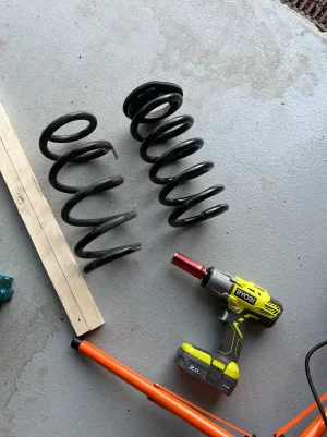

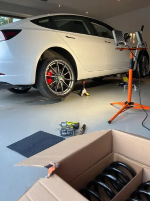

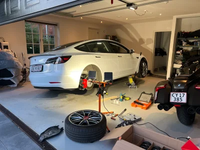

I lowered my Model 3 Performance in my own garage with no prior experience - only based on Youtube videos 😂. I will not do that ever again even though it worked out in the end 😁

This is great news - I haven’t been here for a while 😁
Nice garage 🥰 👍
