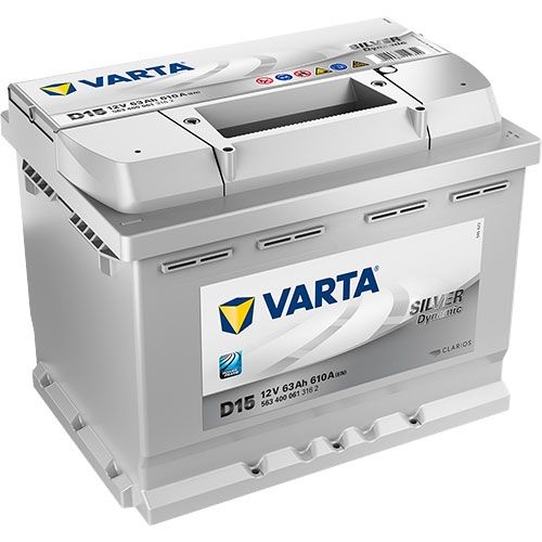

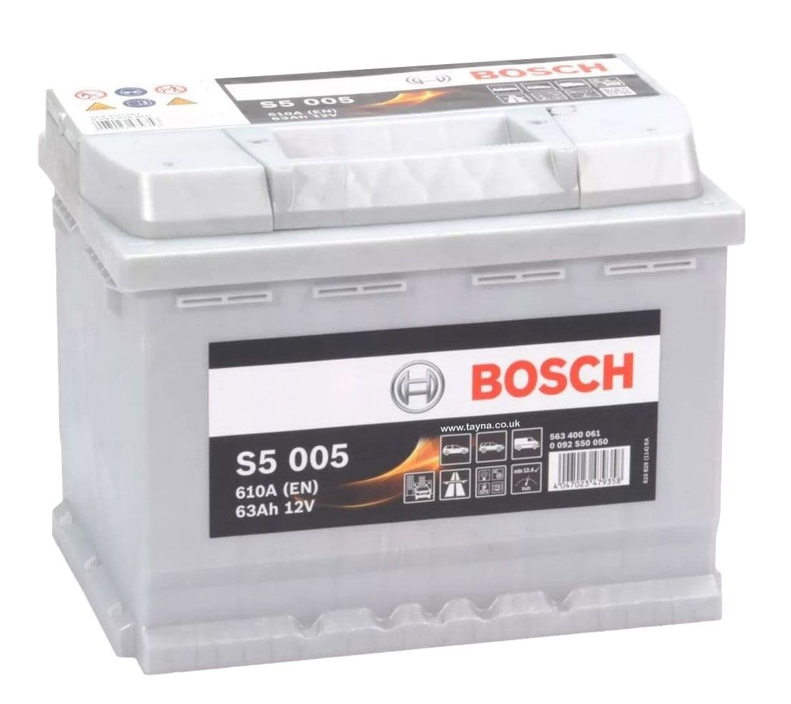

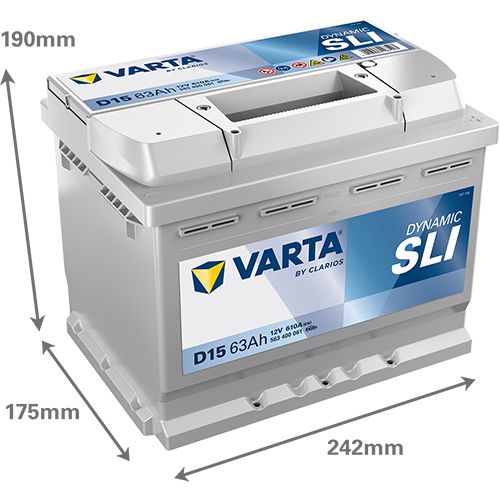

I have experienced this scenario on our Nissan Leaf numerous times over the years whilst leaving it plugged in for extended periods on our 7kw wallbox (ohme smart charger). Using a 12v battery monitor (via bluetooth and its app), I found the logs showed that once the car reached 100% or once it had reached its set target (set on the Ohme), the 12v battery started to slowly deplete more than normal. Whereas during the charging phase, there where times the 12v was being charged up at 14v. I have avoided the Leaf or our MG5 LR being left unnecessarily connected to our wallbox for extended periods of times (beyond just over night) and no issues thereafter. I plan to buy a stronger 12v battery for our MG5 for some extra peace of mind ?
Or this
Or this
Thanks for the info and the links. Your issue sounds interesting as to what happened to mine.
