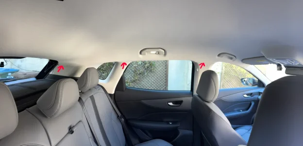

How did you route the wiring for the rear camera?
That was really easy. There is a seam between two panels all along the interior. I fed the cable in there and over the door seal rubber.

Thanks Gadgetbloke, that's interesting. Some people have gone the more direct route because they are worried about the side airbags. I've got a pusher rod thing but haven't got around to using it yet.
