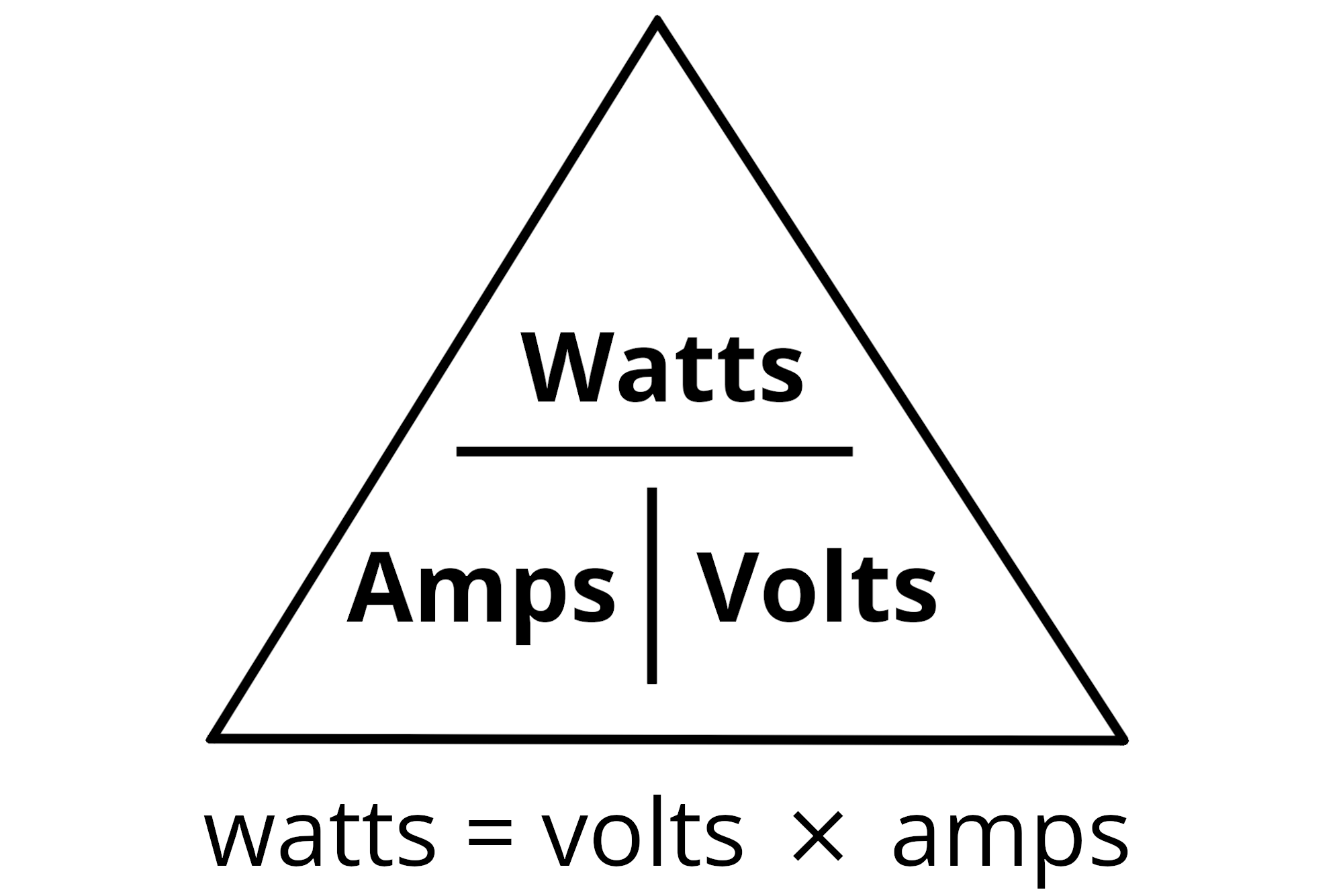

It’s easy!
The current being displayed is the DC current into the battery. C15 amps x c400 volts = 6000 watts. The balance is the lost power in the efficiency of the charger.
The AC current will be higher, 7000/240 = c30 amps.
Sorted ?
The c means nominally.
Cheers - Rob

I believe you need to use whatever the current battery DC voltage is in your calculation i.e. it's not always 400 or 450v etc.
In your example photo it's showing 398v @ -15Amps = 5,970Wh.
So....when you're nearing full charge you should see the Amps reduce to -14.
