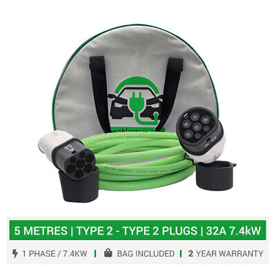

Cardiff MG showroom confirm that the car does NOT come with the Type 2 to Type 2 cable but the granny charger ONLY. They referred me to Amazon to purchase it.
Yup asked Nathanial the same question recently and was told no. Quoted around 170 for 5m one, picked up 10m with bag for 160 online

nonetheless, I personally recommend a 10 meter cable (or at least 7.5 meters) for public charging, had many situations where the 5 meters were simply not enough ...
okay, it is a little more cumbersome to handle, but if the cable is only 2cm too short, you have lost;)
