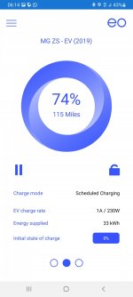

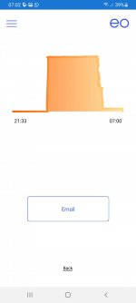

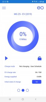

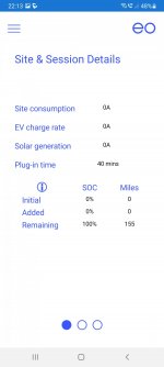

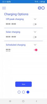

Hi, just set up a scheduled charge with these settings. Will update tomorrow with result
Try it a second time. EO suggested to me that the timer would work once then would require a reboot. It failed for me when the off peak timer was set.
Try it with no settings for off peak, and set the scheduled charging to your off peak times, if that makes sense

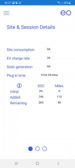

Had mine for over a year now with no problems with the unit or the app. I have two time zones set but use the 12.30 to 4.30 most as I am with Octopus. I do hope they dont try to update as I am happy with things as they are :(.
