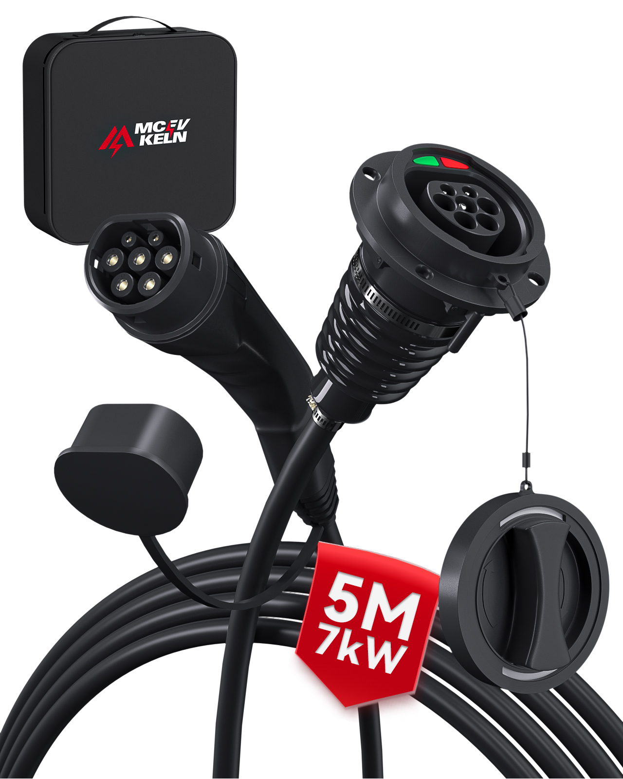

For more info, here's the extension cable on the manufacturer's website.
This is a useful video @Alun26
The only think I'd say as a negative regarding this extension cable, the flexible boot is clearly a CV of some small powered vehicle, a worm clamp holding it onto the back of the plug and some heat shrink sealing the cable to the boot.
Firstly there doesn't seem to be any cable security to prevent the cable being pulled out of the socket. Yes, once that handshake signal is lost, the charge current is cut ... but certainly not electrically compliant
Second, that boot affair certainly isn't water proof to the required specs for an extension cable ....
Basically, it would work, but not particularly safe as far as the standards are concerned. The socket would need to be mounted into an IP 67/68 enclosure, suitably sealed with a suitable cable gland where the supply cable enters .... where the plug goes into the socket .... the whole water and dust protection goes out the window :rolleyes: :eek:
Ratings numbers, the first number is dustproof rating, 0-6, the second number is water proof level, 2 is indoor dry area, 4 is splash resistant, 5 is rain resistant, 6&7 are heavy rain and immersion rated, under water lights etc
So, you can make the socket part safe, but apart from being on top of a tyre, not particularly water proof or dust proof, but then where it goes into the car suffers the same problem ....
For proper safety sake, get a longer 5mm² conductor cable fitted to reach are far as required, at least one less point for water and dirt entry ....
