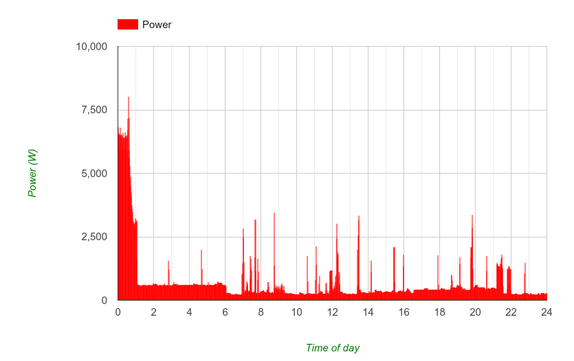

Here's a graph of the tail end of a charging profile
This shows the power usage of my house. At midnight the EV was charging at around 6kW, and at around 1am it got to full charge. It then went into balancing mode, consuming something like 400w for the next 5 hours. Then at 6am it decided it had finished.
This profile is typical. It has this long balancing tail every time I charge it. I assume it's normal.
