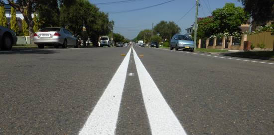

I had time to test it today. And simply said, neither Lane departure assist nor Emergency Lane Keeping recognizes the double solid lane markers.
So either none of the mg4's can do it, or it is simply an issue with my specific car.
Ah.. don't believe everything you read on the Internet ;). Says "Just off Parramatta Rd, Sydney showing a double white solid line down the middle of the road."

So if you have those markers in the UK as well, any idea if it works? I mean, this is about the most important marker the stupid system SHOULD recognize..:mad:

The mechanic asked if I had any issues. Apparently he hadn't read the list yet, but one of the things I mentioned was that any of the three modes properly recognize double solid lane markers. Like these:
He said: no MG does this.
I interpreted his remark as "no MG4 does this", because I know the ZS does, the MG5 does, and now the EHS as well (spare car today).
Do you recognize what the mechanic said?
Just checked on my mg4 and they are detected and obeyed just fine. Of course as long as the ELK/LDP/TJA systems are armed and active (i.e. green line markings symbol in the dash)
