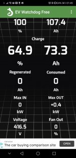

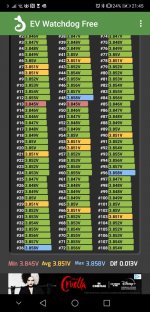

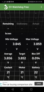

Hi; connected OBD Bluetooth without any issues and got the first reading (see screenshots). It seems not all readings are showing, will compare with app screens...explained under FAQ.

The second a more expensive "Konnwel" Bluetooth OBDII paired and recognised the MGZSEV and read off all the key data especially pleased to see SoC percentage and Ah. Disappointed though to find one cell #61 indicated RED and significantly below the average although #60 was up there with the best #62 was Green and a little higher than #61 and # 63 a little higher than #62 and so over the adjacent 11 cells ramping up to normal level.
Having proof of concept with the FREE version, I must get a screen capture, then do a Ballance charge overnight, and check again. Maybe have a conversation with the dealer but I will also check out what I get with the PAID FOR VERSION.
