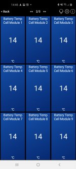

Hi AbuG, thanks for the input, right now I have tested more on what is available in the current beta
version I have access to, the "Battery Temp Cell Module 1 to 9", etc...
I think that's individual temperatures for each of the nine cell packs. It's possible they may vary with one another during charging and usuage. (Or when there is a fault with some of them).
Also from the OVMS PIDs that nix provided there were actually a temp1 and temp2 for each pack. So not certain what's the difference between them but I'm guessing minimum and maximum temperature for each cell pack.

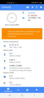

Notify EV displays "min/max/inlet" as per screen shot. Not sure what they mean by inlet..but I'm guessing it's the air cooling at the inlet... may be can use coolant temp for that parameter
