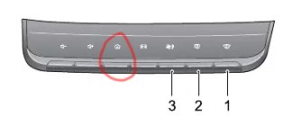

Try to reset the entertainment system by holding the home button for 15 seconds
