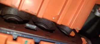

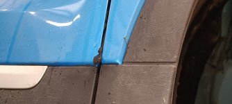

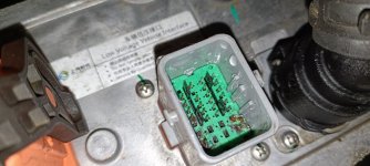

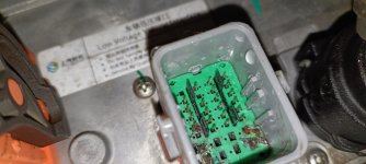

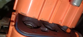

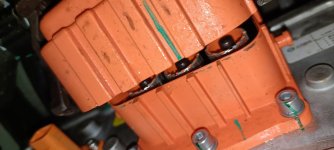

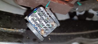

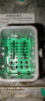

Here are most of the images supplied

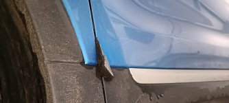

The foam rubber trapped between the front doors and the frame always comes free in the ZS, I've had to poke mine back more than once.
Strange that clear, clean water appears to still be present in the photos as if it happened just before the photos were taken !

So the fault is with the low voltage communications system plug. The HV (orange connector) seems to be dry and free of any corrosion. If MG are writing off the complete expensive battery pack just because a connector has failed then they are complete muppets. It appears they have not opened the battery pack so they have no idea if it's faulty!
I very much doubt this will happen but under no circumstances allow then to fit a new battery and not give you the old one.
In my opinion you have a perfectly good battery that has has a connector seal fail and cause corrosion. All that needs to be done is the battery removed, opened up and a new connector fitted the a new one fitted to the car loom. I am sure these could be sourced from a scrap yard and a decent company like Cleevely Garage would be capable of installing then new plugs etc. It's like them saying there is a connection that is faulty on a diesel engine and saying the only way to fit it is with a complete replacement engine!

After seeing the images I wonder if MG can explain how only 1 single connector is damaged by 'the flood damage'. The abs sensors, the dc connectors, the battery heater connector, the master service disconnect plug are all fine! Seems to me like the seal on the battery low voltage connector was damaged at installation and the corrosion has taken this long to break a connection. The connectors are all facing forwards which is a stupid design meaning all the water thrown up while driving hits the connectors. As an engineer I can't see how driving through deep water could cause this damage, the only way this connector could corrode is if water has seeped in and stayed there over a period of time. On the basis that these low voltage connectors are used under a vehicle they should be rated at IP66 at minimum meaning they should be protected against water being projected in powerful jets - car wash, jet wash etc.
I think they are using the 'sitting in flood water' as being immersed in water requires a higher IP rating.
Anyway worst case you need a skilled independent garage to repair the connections. Best case your Finance company or if needs be an independent EV expert can assess the damage on your behalf and persuade MG that their muppets at the dealer are not qualified to ascertain what cause the water ingress.

I'm no expert in EVs but I am a trained electronics engineer with about 20 years on instrumentation and control systems for all sorts of engines from single cylinder diesel engines to the jet engines powering Typhoon aircraft and the Gas turbines powering our aircraft carriers.
Thanks for uploading the pictures as they make the situation much clearer.
As mentioned above, there seems to be one connector failure only so certainly not enough to justify changing a battery. This connection is supposed to be IP rated so it looks to me more like a material failure and thus a warranty issue.
There has clearly been water ingress but the other pictures don't persuade me that the car has actually experienced a flood.
I still think you should reject the car as a whole as not fit for purpose. The detail of what has happened is not really your problem.
As noted above, it looks unlikely that a case could be made that the car has been immersed, so there must have been a manufacturing fault.
