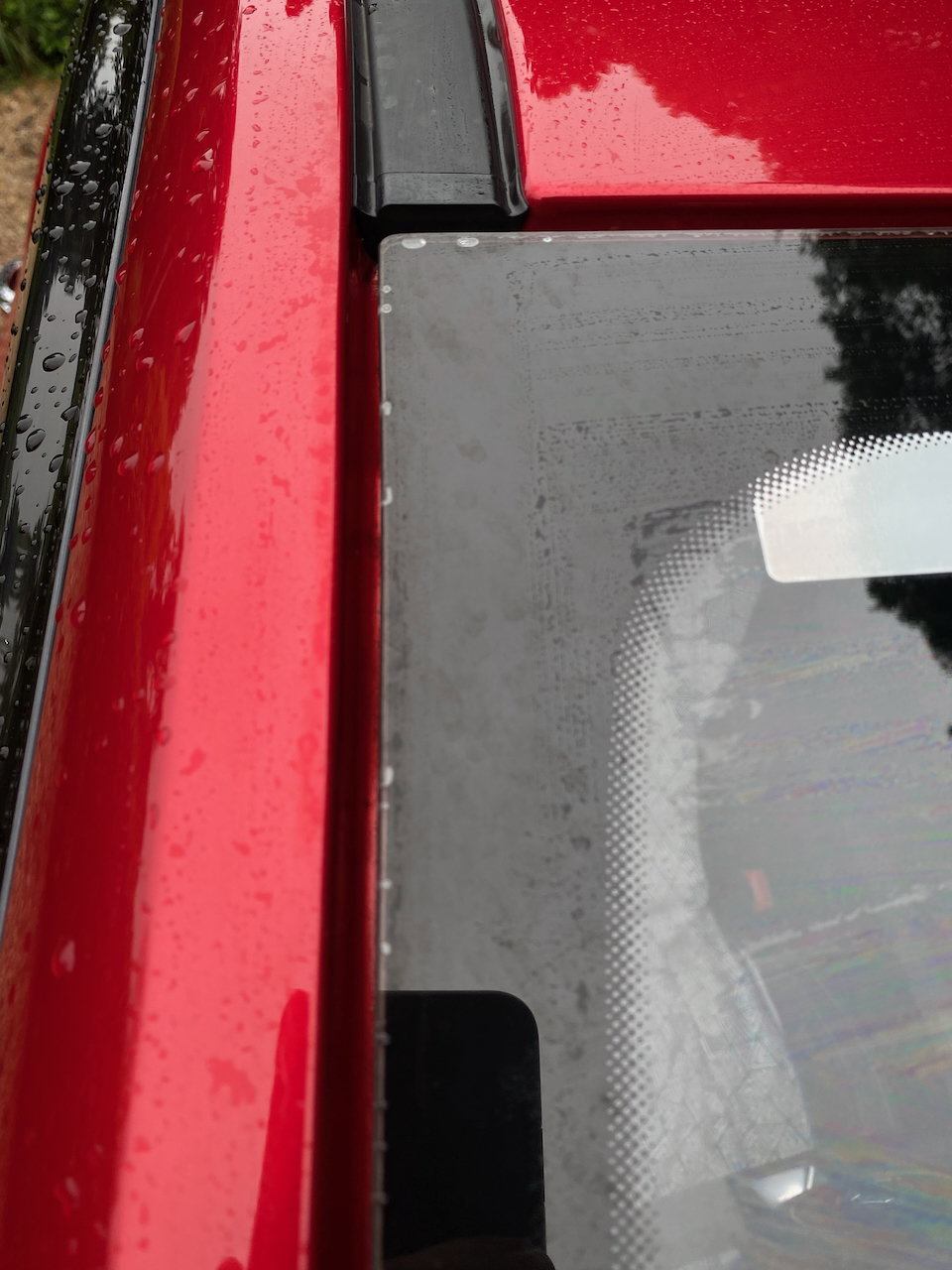

But over the last 12 months I have noticed the edge of my front windscreen showing numerous small bubbles along the edges of the windscreen. It is as if there is some kind of delimitation starting.
I have looked at a few other similar models and noticed that they all have the same issue. My car is in Queensland, Australia. I asked for MG to check if this was an issue at its last service but I have not heard anything more. I wondered if any other owners have similar degradation effects and what, if any action they took to get it checked and resolved with MG under warranty.

My fault(s) is on the outer edge of the front windscreens and maybe the wrong glue for Australian conditions (light is very harsh in Queensland) could be a reason for this. I'll take a picture to make this clearer and add it.

Here are pictures of the frit problems on the front screen edges. It rained this morning but the bubbles in the screen frit area are easily distinguishable.
Doug

Looks like the layers of the windscreen aren't sealed properly, and you're getting water ingress.

I'd guess it would only get worse 'if' you get water ingress and 'if' that water freezes, and 'if' that volume of water is great enough to force the laminated layers apart. I would say unlikely i the short term.
