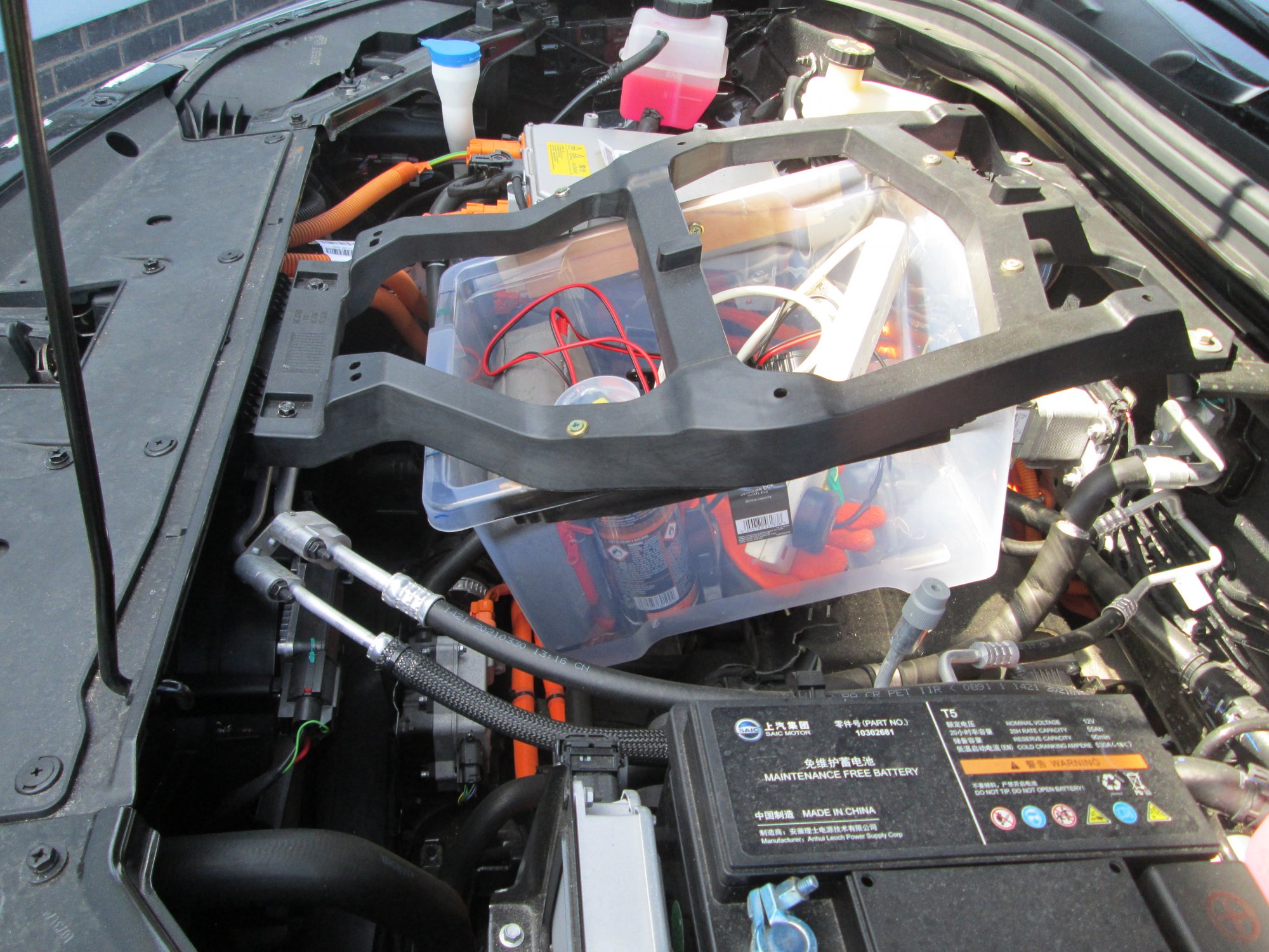

Any one fancy some DIY to save some money? I knocked this up and it works fine, I'm sure someone could do a better job than me. I had to take the motor cover off when I couldn't disconnect the charge plug at a charger so needed the emergency release and couldn't be bothered to refit straight away. Saw the big unused area so decided to see what I could come up with. I could fit a larger box with a cut out for an air con pipe that's in the way. The one in the EV accessories film has a cut out for it. I bought the box in Asda for £3, added some wood off cuts under the lip of the box for strength and drill/screwed straight through the plastic carrier.
Any one fancy some DIY to save some money? I knocked this up and it works fine, I'm sure someone could do a better job than me. I had to take the motor cover off when I couldn't disconnect the charge plug at a charger so needed the emergency release and couldn't be bothered to refit straight away. Saw the big unused area so decided to see what I could come up with. I could fit a larger box with a cut out for an air con pipe that's in the way. The one in the EV accessories film has a cut out for it. I bought the box in Asda for £3, added some wood off cuts under the lip of the box for strength and drill/screwed straight through the plastic carrier.View attachment 8192View attachment 8193
There’s a thread kicking about with similar solutions to this - the ZS frunk has a bit more width but unsure what the final version of MG5 from this company will look like. Possibly not too dissimilar to these box solutions.
