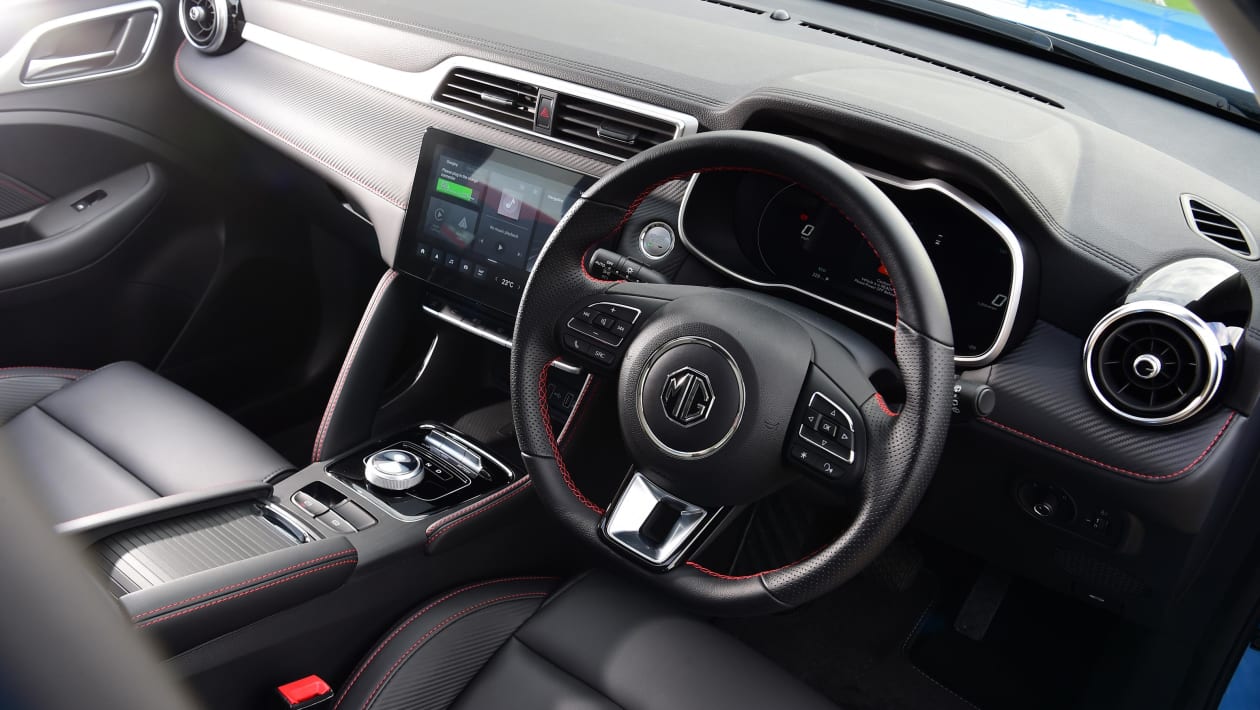

Hi All, pls can someone tell me where adjuster control is for headlights? Mine are only lighting up 30 ish metres of road ahead - thanks
Assuming new model ZS, RHD: to the right of the steering wheel, roughly knee height. See this picture: https://media.drivingelectric.com/i...ivingelectric/2021-11/New-2022-MG-ZS-EV-4.jpg and look below the air blower on the right, you can just about see the controls there. It's a small thumb wheel with numbers.
LHD is probably the same, but on the opposite side.
Point to note, it annoys me that these are literally knotched settings rather than a pure analogue. I often think one setting is too high, and the next setting is too low. No way to set in between...
