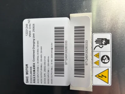

To determine whether V2L can work on our vehicles, could you please open the lower section of the trunk and share a photo of the CCU unit?
it looks like this :

Here is a couple of photos

The question is, when were yours manufactured? Just because it was bought in 2026 doesn’t mean it was manufactured in 2026. The new models have USB-C ports and, according to my information, they also have V2L. The ones with USB-A ports definitely don’t have it.
Mine was first registered in May 2025, but it was actually built back in September 2024.
True, that may help to explain it. Mine has USB-C ports and a V2L tab on the battery screen. It’s a shame they all can’t be upgraded by a firmware update….
