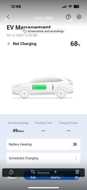

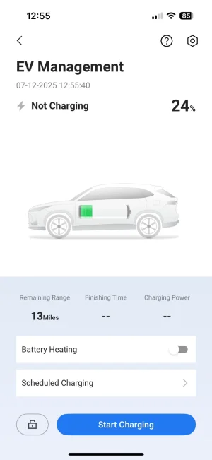

Hello Totti1001, I’ve attached a couple pictures but as an example, the estimated remaining range was 49 miles, after driving approx 10 miles over three separate journeys, the estimated range has dropped to 13 miles.
The outside temp has been cold, certainly between 0 and 8/9 degrees so I have had the heating up quite high.

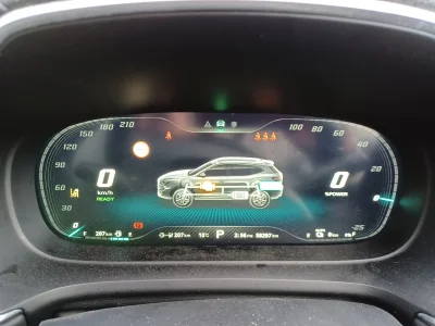

Hi Louise, I have an older HS PHEV model (2021) and, with the on-set of winter I was similarly confused about the increased rate of consumption of the high-voltage battery. In fact, I even brought it to the garage who have little to say for themselves but when I got the car back, the driver display was set to the graphic below. This is a fascinating insight into the inner workings of the hybrid system and the subtle interplay play between the battery and ICE power sources. For me, it explained everything fully where my battery power was going to. The graphic is fully animated so shows you dynamically where and when the power is coming from (ICE or battery) and going to (wheels or battery or both at the same time).
You can get to this display from the normal default display (current journey details) by hitting the up arrow on the right-hand steering wheel control cluster.
If you leave it set to this display for a day or two you should see what I mean. You might be surprised at how easily and how often the ICE is called on to support the battery and, equally, how often the car is running on battery power even when not in EV Mode.
That's my 2 cents' worth. Hope it helps.
