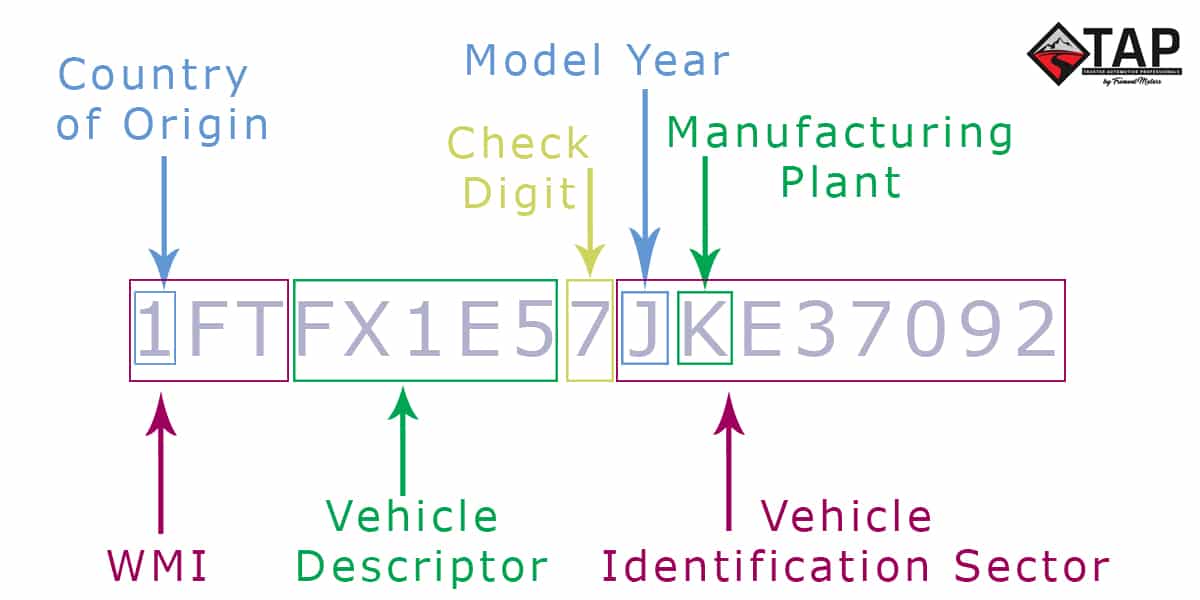

As far as I am aware the tenth character of the VIN is the year of manufacture code. L is 2020.
Hi James, I asked the guy at Perry's if the VIN code did say anywhere the month and date of manufacture and he said apparently not, he read all the information on his SIPs screen to me as he too was looking for the month of manufacture to determine when the Comfort 2 update was done as the car arrived with it already installed but the other updates could have been missed. I will let you all know on Friday this week what they find when they connect the SIP's to the car, I am sure all will be revealed.
Both these sites show how to decode VIN numbers, the second site has a table to show the year letters and coincidentally the letter 'L' is 2020.
I would have thought that VIN numbers have a legal requirement to show all the vehicle details.
I have a 2019 Tesla M3 and the 10th digit is 'K'
My wife has a '20' reg (March delivery) MG zs ev and the 10th digit is also a 'K' indicating 2019 as year of manufacture.
Might I suggest that those with 2nd cars check the 10th digit against the table on the second site link to see if this theory holds water.
That's the same website I checked for VIN details. I take possession of my ZS EV tomorrow and checked the VIN against the decode. Year of manufacture for mine is L = 2020. Don't see that you can determine month of manufacture which is a shame.
10th digit on my 2016 Prius is a zero not a letter, so no.
Could you post a photo of the VIN? Everything I read states that the 10th digit is year but a 0, as you say, suggests something else.
What year would it be if the zero was a letter "O" ?
Edit: just realised the letter O is not used in the VIN codes.

My Mazda MX5 VIN code show digits 10 & 11 to be to be 'zero & zero' site of manufacture is 11th digit either 0 for Hiroshima or 1 for Hofu, being as the letters I, O, Q are not used in VIN sequencing that still leaves the year in doubt.
