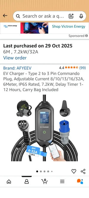

I bought one of these and paid a local electrician to install the relevant socket on a dedicated 32A circuit - total cost under £350.
I did consider the added practicality of being portable, but so far only ever used it at home. I guess it's also beneficial if you plan to move home and just need to get another socket installed.
Also mine is tucked safely away in the garage, the 6 metres is plenty to reach under the closed garage door to the ZS. 👍
