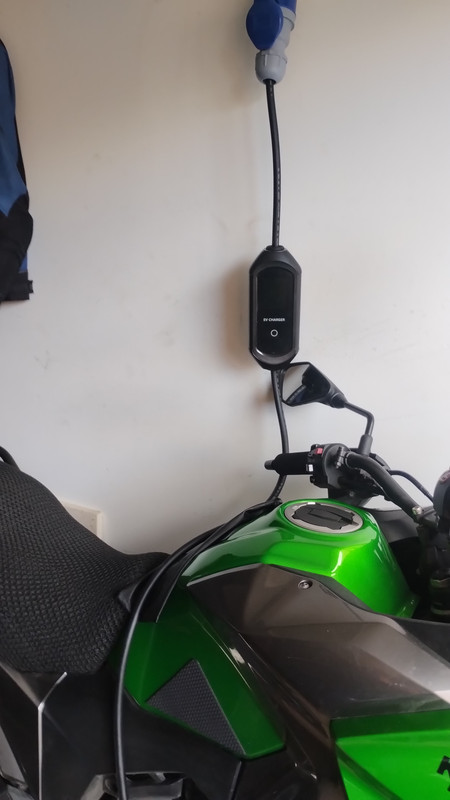

Rather than a fixed 7kW wallbox I bought a "portable" 7kW with 32a Commando plug (round industrial standard), then paid £250 for an electrician to install the corresponding socket in the front part of my garage to a spare consumer unit RCB.
It easily reaches under the locked garage door to my ZS LR, saved £500 over the fixed option and allows me to carry the charger to a second home in France.

(y). A few of us have gone down that route...
