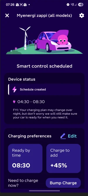

So yesterday the car was at 49%, so I set it to add 45% to be ready by 08:30.

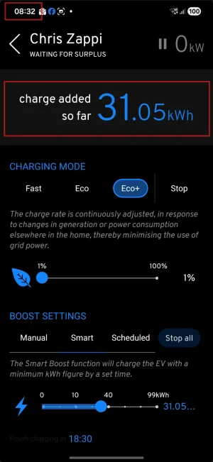

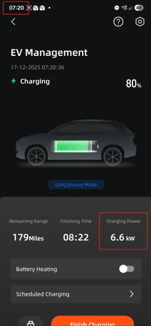

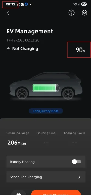

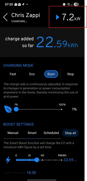

While it was still charging I checked the charging rates. Zappi was saying the power was 7.2kW, yet the MG was saying 6.6kW (see screenshots). When it had finished Zappi says it had added 31.05kWh (which is 50% of the 62kWh usable capacity), yet the MG says it is now at 90%, ie it has added 41%, which is around 25.5kWh.
What is going on? Where has that extra 5.5kWh gone (31-25.5), which I'm being charged for? I'm only getting 82% of he energy I'm charged for into the car.

Inevitable losses. Most will be lost in the conversion from AC to DC within the charger. Some will be used to heat the batteries to a suitable temperature during charging. Some will be lost powering the vehicle's electronics. Some, hopefully a smaller amount, will be lost as heat in the cables between the Zappi and the EV.
